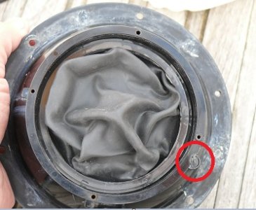

The filling screw is located here (picture)
before filling, put everything in the fridge (compass+replacement fluid) for a few hours. When filling, keep the screw in the topmost position, then insert additional liquid to well expand the membrane. Insert the filling screw and twist it a little bit: while gently oscillating the compass with the screw on top, push the membrane to help air come out, when you only see liquid squirting out tighten the screw. It is of course important not to leave the membrane overfilled and bulging. You might have to repeat the procedure one two times. Not really different from priming a CAV filter with all the mess it involves :D
Once you put the compass in the upright position, if there is a remaining small air bubble (say a few mm diameter) try and leave it there it will most likely disappear as compass and fluid reach ambient temperature.
