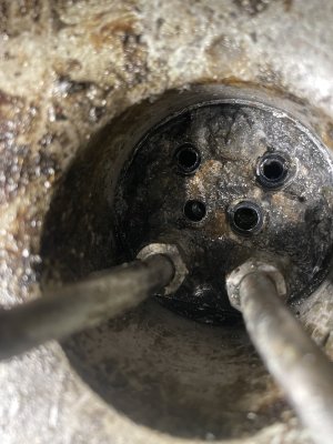

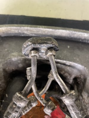

If I take the front 2 hoses off is it possible to chip away at the manifold until it’s free. Just nervous in case I do any damage

It just sits in a hole with four ports that line up with the hoses, you could try to tap it with a punch near the edge and try to get it to rotate in either direction, never seen this problem before.

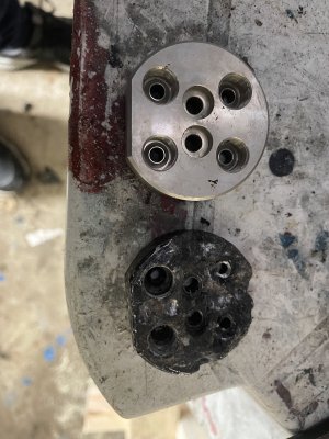

I eventually got it out . It’s fairly corroded.

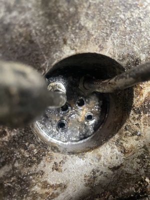

I am going to attached new hoses and I was wondering to I need to put a sealer on the 4 hose connections that sit into the manifold

You need to fit 4 new O rings which sit between the transom and the round fitting. The hose unions need to be tight as they can leak and you will need a crowsfoot spanner to tighten them once the fitting is in place. I always fit the 4 hoses to the fitting with it in a vice and make sure the angle is right or you will struggle to get the hoses to match up with the cylinders.
