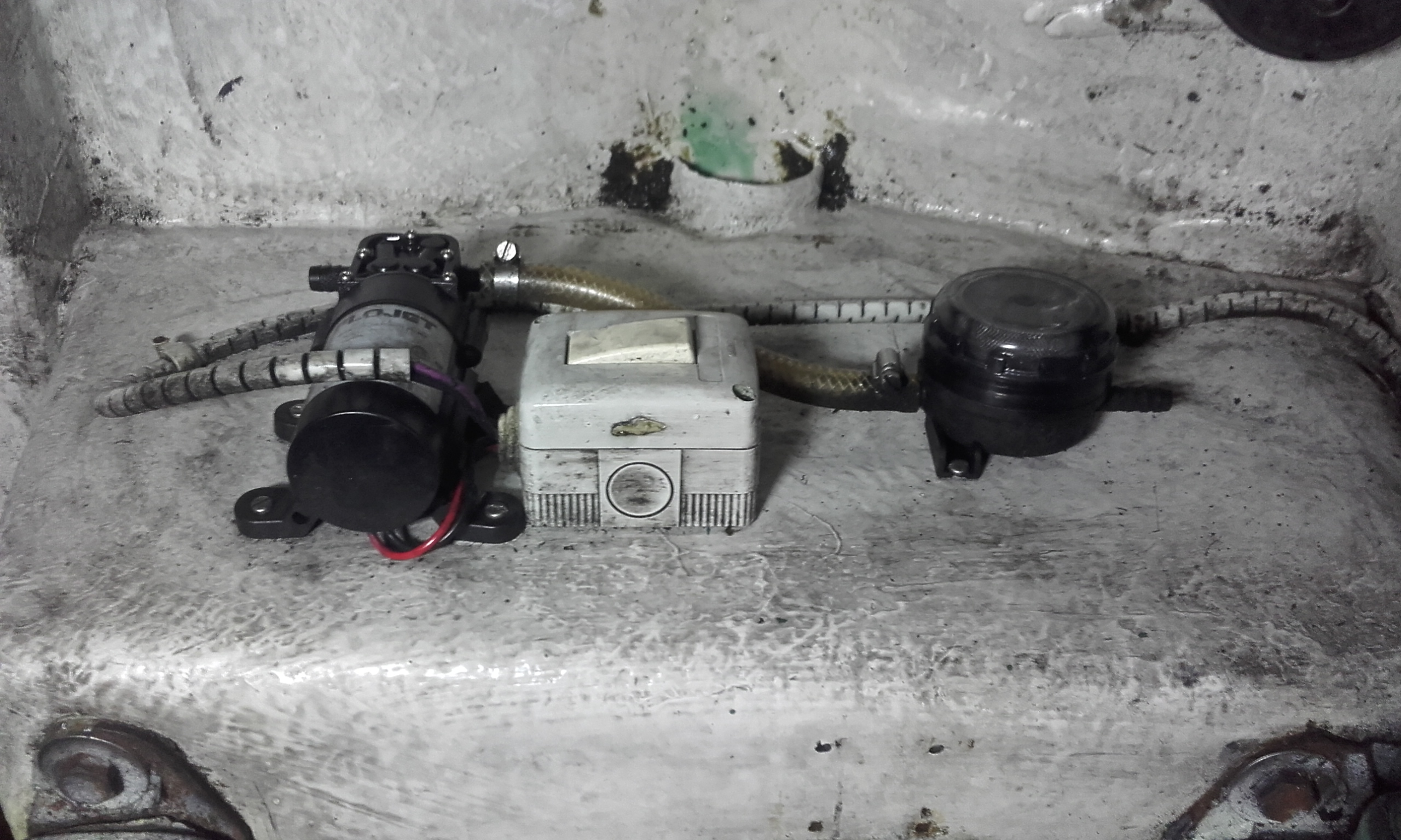

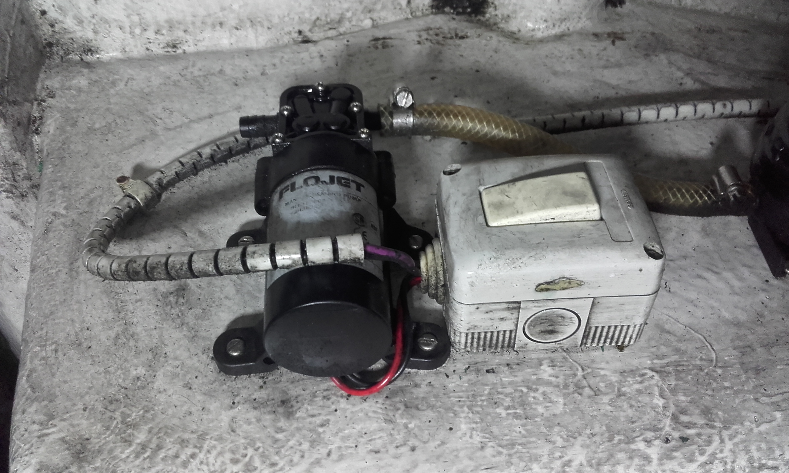

My boat has a small Flojet self priming pump which I think is to get the dregs out. Excuse dirty bilges, now much cleaner.
Some pics...
It's not currenty sucking anything up, anyone got any ideas for fixing it?

Pete remove the cover highlighted in red , carefully remove the rubber valves / diaphragm s , clean the crap out .Reassemble
The repeat every 5/10 mins of operation .
Dispite a pre filter .
Don,t ask me for “ evidence “ ——— put it down to experience as my post ^^^^ .
Goog Luck for all trying to persist we an electric untility pump btw !
Thanks Porto. That'll keep me out of trouble for a hour or so!
