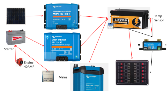

Thanks for all the feedback, I think I have this now, please see below, any comments please.
So my shopping list looks like this
ECO-WORTHY 12V 280Ah LiFePO4 Lithium BatteryPardon our interruption...£450
Or
12V 300Ah Lifepo4 Battery Lithium Leisure BatteryPardon our interruption...£280
Victron SmartSolar MPPT Solar Charge 100/50https://www.amazon.co.uk/dp/B073ZJ43L1 £130
Victron DC/DC Charger 12/12 - 18 (Max 20A)https://www.amazon.co.uk/dp/B0851TPKV7 £130
Victron Energy Smart Battery Shunthttps://www.amazon.co.uk/dp/B0DJ2P2XN5 £060
Victron Blue Smart Charger (Main)https://www.amazon.co.uk/dp/B082X98M79£120
You will see I have listed 2 batteries here, 1 a lot cheaper then the other, anyone got any thoughts on these two please, is there a reason for the price difference?

I definitely wouldn't touch the cheap lithium. I would look at the Fogstar range of batteries. More expensive but known cells and bms. UK company so warranty will count for something

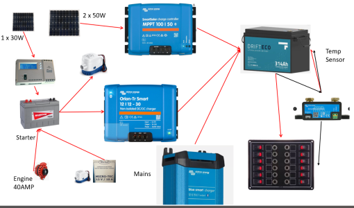

Thanks for all helpful feedback, I now think I have all but one thing sorted and understood as per diagram shown below.
My last question is in regard to our bilge pump, this is of course always on and at present is directly connected to the starter battery. We have never needed it and hopefully never will. My question is can these be connected directly to the lithium battery or should I leave as is?
So what I have now is
Starter system – Standard battery charged as follows
  • 1 x 30w Solar panel via existing charge controller
  • Engine alternator (40A)
  • Mains via Micro-Tec battery charger
House system – Thrift 314Ah battery charged as follows:
  • 2 x 50 W solar panels via MPPT 100/50 charge controller
  • Mains via Blue Smart IP22 Charger 12/20 battery charger
  • Engine alternator (40A) via Starter Battery and 12/12 DC/DC charger
I will also be fitting the Victron Energy Smart Battery Shunt, so the total shopping list is below
  1. Fogstar Drift ECO 12V LiFePO4 Leisure Battery
  2. Victron SmartSolar MPPT Solar Charge 100/50
  3. Victron DC/DC Charger 12/12 - 18 (Max 20A)
  4. Victron Energy Smart Battery Shunt
  5. Victron Blue Smart Charger (Main)
I would hook the bilge pumps up to your lithium battery. If your boat is sinking you want the pump to run for as long as possible :)
All good stuff, but i'd go for the Fogstar drift, rather than the ECO. A little more money, but well spent as they use better cells and better BMS with Bluetooth (Bluetooth is a must).
You can safely use a much smaller (and therefore cheaper) controller. Even the smallest Victron 75/10 is big enough for two 50W panels.

At what battery voltage? Although Victron suggest under-speccing to save money, it does waste Watts that could have been captured.
600W at 12V is 50A so a 100/30 is not at 50% in that scenario, but 24V it would be fine (still not 50% though!).
24V obvs, I'm pretty sure never seen more than 15A@27.2V whilst charging (doesn't charge at 24V...) but then again being flat on the hardtop means they are never at full power output.
I'd expect more than that, are they shaded by antennas etc. at all? Even on a UK summer day you should get 100% rated output or slightly over that (we get 105% on our Renogy flexi panels). In Greece you should get that fairly consistently I'd have thought. Are the cables thick enough for the run length?
yep, cables thick enough, and they are in series, so 85-90V coming down so no need for extra thick cables. I'm a bit worried myself tbh as it seems that performance has dropped over the last few years, panels are 10yrs old now (proper rigid ones). And yes, no shadows really when the sun is high up.
Thinking of redoing the f/b connectors they are meant to be properly sealed ones but who knows...
Other than that, probably replace the panels in a couple of years time.
