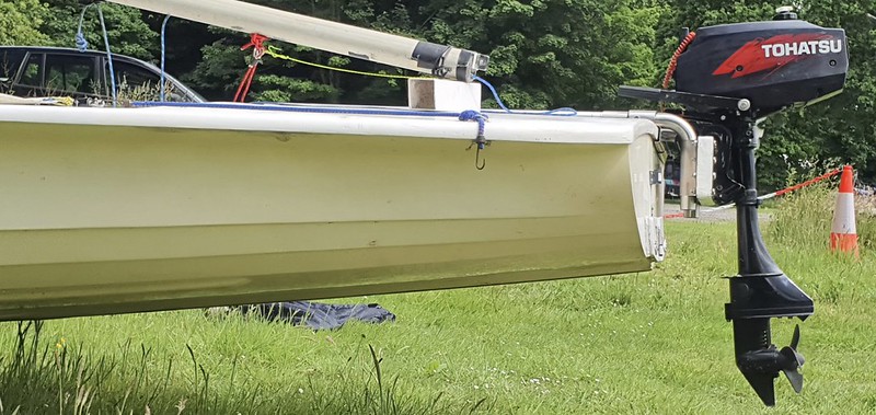

Not that an outboard couldn't be mounted, even on a Laser...with enormous care and expenditure, some brilliance and weeks of effort, I fabricated a bracket that allowed me to fit my Tohatsu on the back of my late Osprey, without drilling any holes in the boat or reinforcing her structure...
...it's so darned good, I'm not keen to part with the bracket, even now I don't have the boat (I could be persuaded to sell it, but this is scarcely the place).

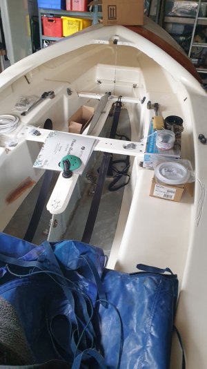

An old Lark might fit your bill, can be picked up for very little. Or firefly, mirror? Graduate, Heron.
I'm 80% through refurbishing a Lark, never actually sailed one but I crewed in 505's for a guy who had been National champ a few times.
It looks like it will be a bit of spritely fun with grandchildren this year, It's a Parker GRP boat, was cheap to buy and with the mods to bring it up to date will be on the water for under £250 looking smart and with decent gear and half decent sails too, might even do the odd club race.
I did a similar project with a GP14 during Covid, a heavy barge of a thing the grandchildren and I got tired of and rid of quickly.
