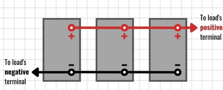

The challenge of making the 2 batteries share load and charging evenly is removed and make wiring simpler.
When you wire two batteries together in parallel, you should take the positive from one battery and the negative from the other. That means the current passes through the both the positive and negative interconnections and should discharge the batteries equally. Like this:
If you do it with the load connected to one battery, with the others in a string from that you will get unequal discharge due to the resistance of the interconnecting cables. The battery nearest the load will discharge more than the other.
Connected as above, there should be no problem with equal charging or discharging and they will self balance.
a. I would take option 1 and fit a second small charger for the engine start battery.
b. Why fit 2 x 100Ah batteries and not 1 x 200 Ah battery. The challenge of making the 2 batteries share load and charging evenly is removed and make wiring simpler.
c. A good battery monitor like the Victron BMV 702 gives you a really good indication of state of charge and is well worth the money.
Two batteries is the ultimate set up. If a BMS faults for whatever reason, it will leave you with 50% of your capacity to keep things running. Balance between two lithium batteries not much of an issue.
The best wiring arrangement for lithium is to run equal length wires to a fuse then isolator for each battery. From each isolator, run the wires to negative and positive busbars.
Not sure how you can easily do this with 4 x 3.6 v in 4S battery packs and bms for each battery
You just treat them as two separate batteries of 4 cells and let the BMS sort each one out. The balance of cells within each battery is important, but the balance between the two batteries doesn't really matter that much. If wired as I showed, they will stay in balance anyway since as soon as one battery's voltage drops below the other the balance of current drawn from each one will change to match.
Generally with lithium people are using equal length cables and a busbar rather than this that we’d have done with lead. Whether it’s worth the faff is debatable but seems the way the crowd is going.
I think the driver for seperate, equal length cables comes out of the recommendation to fuse each battery separately and use individual battery isolators. Once you adopt this approach, it lends itself to the use of busbars as well. It makes for a better install in my opinion as you can isolate an individual battery whist keeping the system alive. This may be useful if you had to fix a bad connection, swap a BMS, change a fuse, etc or if you were dealing with a lithium battery that may have failed and you want to isolate for safety reasons.
