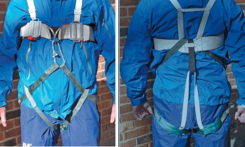

This was an experiment in leg loops that move with the sailor, can be fitted to any sailing chest harness or PFD, and can withstand an actual drop test with no bruises (tested with five 2-meter drops using a person, until the climbing rope used was showing signs of failure). They are feather light and self-adjusting so that they move with the wearer (the cross-overs at the hip slide when you rotate your torso).
Such a harness could also serve well on the foredeck, up the mast, or during MOB recovery.

All good .... but isn't there a benefit to being simple ?
Put jacket on ... reach under, strap round and clip .... done.
Absolutely. I agree. The harness shown takes a minute to put on. But some smart guy ought to be able to find a middle road. The above harness is MUCH more comfortable to wear, even without falling. It NEVER falls behind a knee when you squat and it NEVER pinches.
