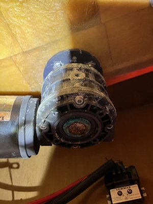

My Lewmar windlass has gone very slow and grinds to a halt after a few revs - even going down under tension. The terminals are clean and voltage at the motor is fine. Please see picture below

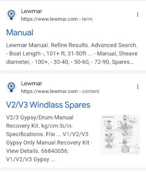

1. How do I tell if its a V2 or V3 Lewmar ?
2. Where can i get a manual ?

The serial number on the gear is 60000569SPA - V2/3NONFFGBOXRMU501/70

Have got the windless off and apart. It was seized solid.
Got it off by making a puller using the 4 M8 screw holes in the bottom of the gearbox to pull it off the shaft ( from below after loosening the top M 8 nuts holding it up.
The top section was stuck down on a bed of sika flex. Pulled it out by tying the chute haliard round the drum and winching. Very tight but suddenly the top section came off and flew about 6 foot up. Fortunately it was tied on !
