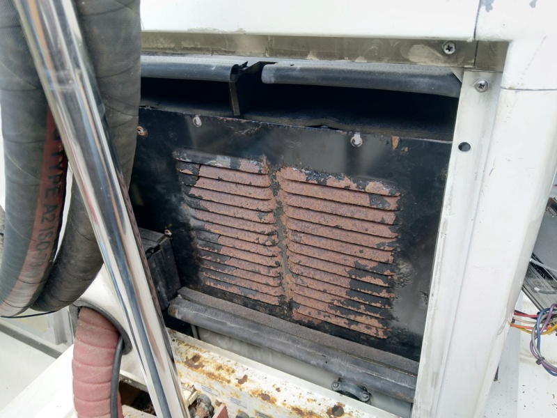

I've started to tear apart the housing and I think I know that the SCR unit is in the black cabinett behind the ADC panel, opening up the side of the genset reveals a black plate with vent holes in it, tried unscrewing all the screws to the plate, but I cant still get the plate out of there.
Any ideas how to get to the SCR box to have it tested/replaced? We've had the error for the last two years, but never needed the genset so haven't put any effort into solving it until now.

The SCR is almost certainly OK, however if you really need to get it out, the case does eventually come apart once you remove every single self taper/screw etc. Start at the top and work your way down. Note some of the screws go into captive nuts that are riveted to the aluminium frame, corrode and come loose and just go round and round so you will need a pair of molegrips too.
Are you saying that the black panel should come out without removing the white framing from the sound insulating box as seen in the picture? Read somewhere online that some bloke changed his SCR and it was a 1 hour job .... I've been at it more than 1 hours to say the least.

Regarding the case, it's been a while but I remember removing the control panel first, then the black metal covers under the top cover, then I think it got easier. It took me more than an hour it's not obvious.
