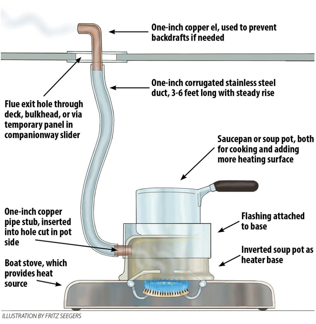

My PDQ had lots of systems, but the F-24 I have now is quite simple. But I still have heat.
Regarding heat, something that vents outside the cabin (not a lamp) is much drier and really worth it in the cold and damp. It can be something simple. However, it truly helps to have a very small fan blow across it and the flue to spread the heat. I use a tiny USB fan sitting on the gally chopping block on my F-24; just enough to move the heat without causing a big draft. I don't leave it on at night, but I like thick quilts.
Hot Stuff – DIY Sailboat Cabin Heater | Good Old Boat
