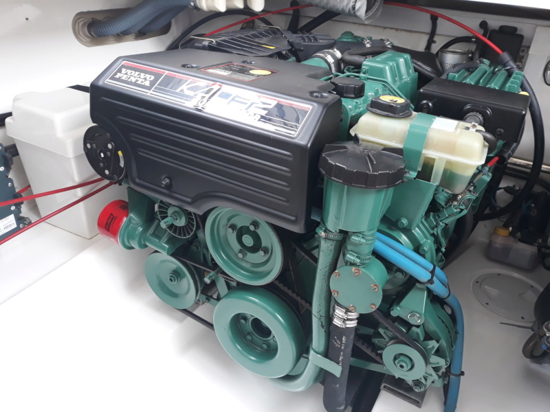

Helping to refill my friends power steering system at the weekend, but the manual seems a bit short on info. I'm guessing ATF will do the job, am I right? Anyone know how much it takes? I have a couple of litres of ATF and, assuming it's the right stuff, need to work out if I have to buy more.

If it's the power steering tank on the engine, manual says "ATF (Dexron II)".
If I remember correctly, a litre or so would do it.

Yes that the one. Little tank mounted on engine powered by a fan belt. Dexron II is what I have so it looks like I’m good to go. Cheers

I think the power steering fluid reservoir may be remotely mounted ?
Yes, AD31 has the tank around and above the pump.
KAD32 is remote.
