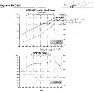

Sorry, should have more specific , trying to find out if the increased fuel efficiency claims for 300hp D6 over the KAD 300Hp are marginal
or impressive.
Cannot find any KAD300 graph to directly compare to the D6 of identical horsepower.

Think did spot that one but that was in specific boat Windy ? and wanted to directly compare figuires on a dynometer etc.
