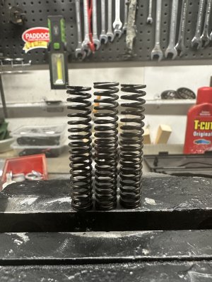

Interesting indeed. I have now got two of these oil pressure control blocks on the bench, one with brand new springs & pistons. I intend to measure the length of the used and new springs to see if there is any difference. The only other issue I can imagine is that one set of springs (or indeed just one spring) has lost some of its compression strength, thereby making it easier to compress, this would indeed explain how your fix had a positive influence on the oil pressure.

The two springs are the same part number and therefore, I assume, interchangeable. It must have been a real difficult job to shim the springs with the engine in the boat, I had to remove header tank, heater exchanger, supercharger, oil cooler etc etc and then the unit itself, before removing the control bock and dismantling it.
So, here is my assessment of it:
Valve springs from oil control valve block. The one on the left is from the engine oil pressure reduction valve, the one on the right is from the piston cooling valve, the one on the middle is an unused one. They should obviously be the same length. I’m thinking that the oil pressure reduction valve would have been opening at a lower than designed pressure due to the reduction in the compressive strength of the spring, thereby resulting in a lower engine oil pressure.
