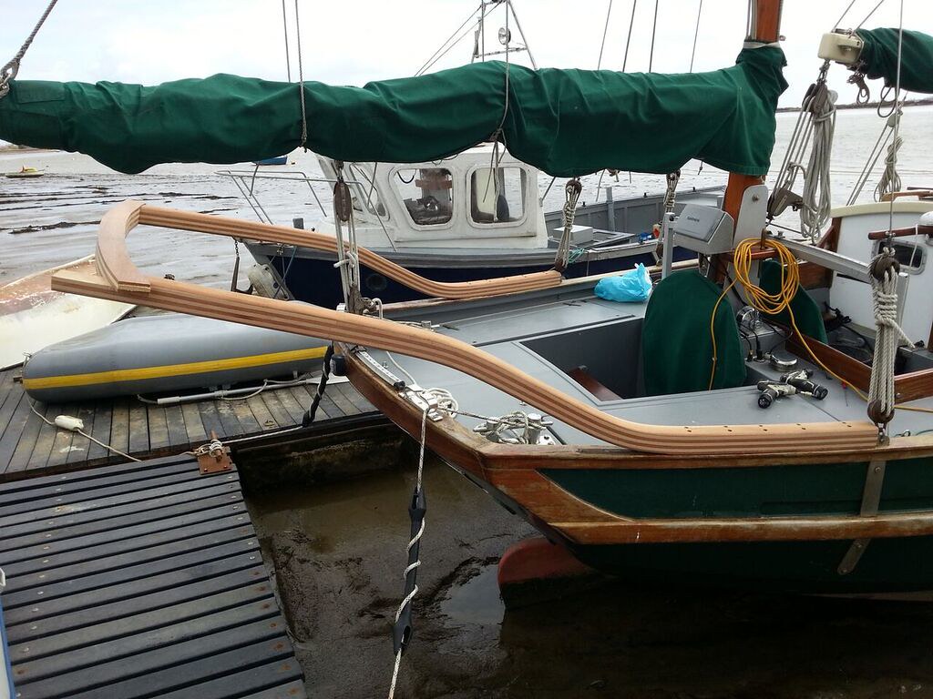

Wonder what it would look like if made in wood ??
