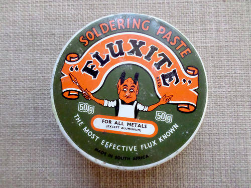

Something like this? I've got one.

Fluxite contains zinc chloride. Its intended for engineering and sheet metal work. I'd not use it for electrical wiring or electronics
These days there are better fluxes around.
Some of them are available in a 'felt tip pen' dispenser.
Look for 'no clean flux', this means it does not need to be removed after soldering.
