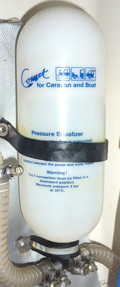

I've put a link to a picture in my question above. Is this an accumulator? If so, they are pretty cheap at a caravan shop.
Yes, that's the simplest type. No diaphragm, which means they have to be mounted as shown. The ones with a Schrader valve are usually the diaphragm type. The valve allows a little more tuning than your version but essentially both will work equally well.
The one in the picture has (seems to have) no means of matching the accumulator pressure to the system pressure so not so much use as a true accumulator and more a "smoother" , mind you most proper ones are not adjusted annually or indeed on installation to the correct pressure anyway, so probably no matter anyway. I have yet to find one adjusted correctly on a service visit and they might as well not be there, well almost. The accumulator should be set at around 3PSI below pump cut out pressure and that should be done with no pressure in the water system, preferably with Nitrogen s that is what is in most potable accumulators ex factory.
