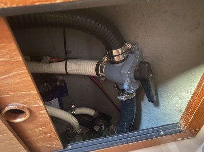

Just makes me glad that our holding tank has a pump to pump it out and a changeover valve to pump straight to ocean when it’s not in use.

Not nonsense. I respectfully suggest that a minor hold up that the force of gravity doesn’t deal with might be cleared very easily with the suction of the hand pump that empties our holding tank. We’ve got a shore pump out option as well.
And we have no problem with moderate amounts of toilet paper. In fact we’ve never had a blockage of the tank with our use.

I had the first 2 tanks I installed custom made with the pump out immediately above the the outlet to the seacock specifically so that it could be rodded without removing the inspection hatch.

I completely agree with your sentiments re all effluent going through the holding tank. I appreciate it’s the way some boats are plumbed but it’s not my preferred choice.
A nice big valve to choose ‘To Tank’ or ‘To Ocean’ works for me.
I’m still convinced that having a pump to physically empty the tank is superior to a valve and relying on gravity.
