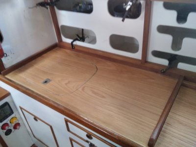

Depends on whether you value the extra worktop space. Sinks are only used for short periods when they need to be open and are good dumping grounds for things when not in use. So covers useful. The first photo shows my original galley with the inset sink and cover on the left. The cooker has a cover that hinges down from the bulkhead. The sink cover stows under the cooker when not in use. Second phot shows the revamped galley (not quite complete) with the formica covered by American Oak veneer including the sink cover.
Suggest you make the cover in 2 parts and stepped so that it does not slide when on the sink.
