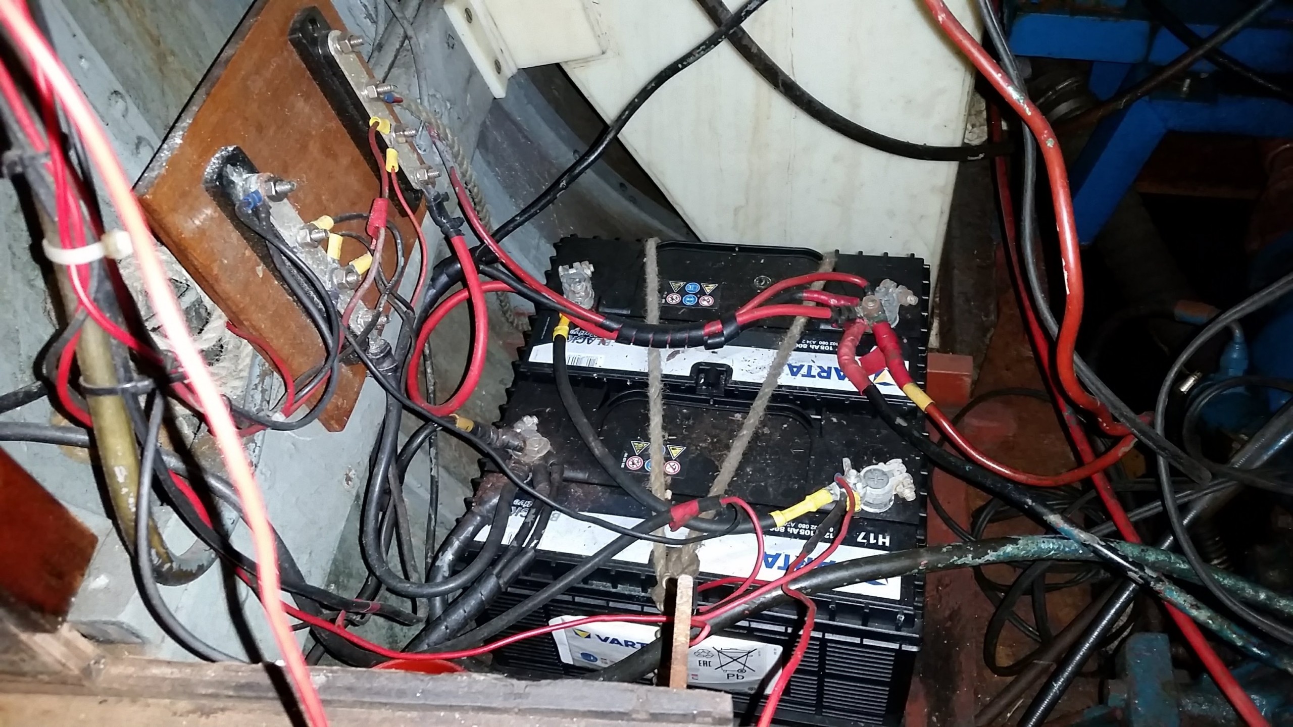

Multiple connections at the battery is almost always a bad idea, as the rats nest in post #1 demonstrates. Generally:

i already have MCBs on each battery, the main boat panel and fuses on the solar cables. it isnt much of a nest, the engine battery is located at the front of the engine so the heavy cables go to an mcb by that first before going to the battery then to the blue sea switch/relay by the house battery, and its a small boat, not much space

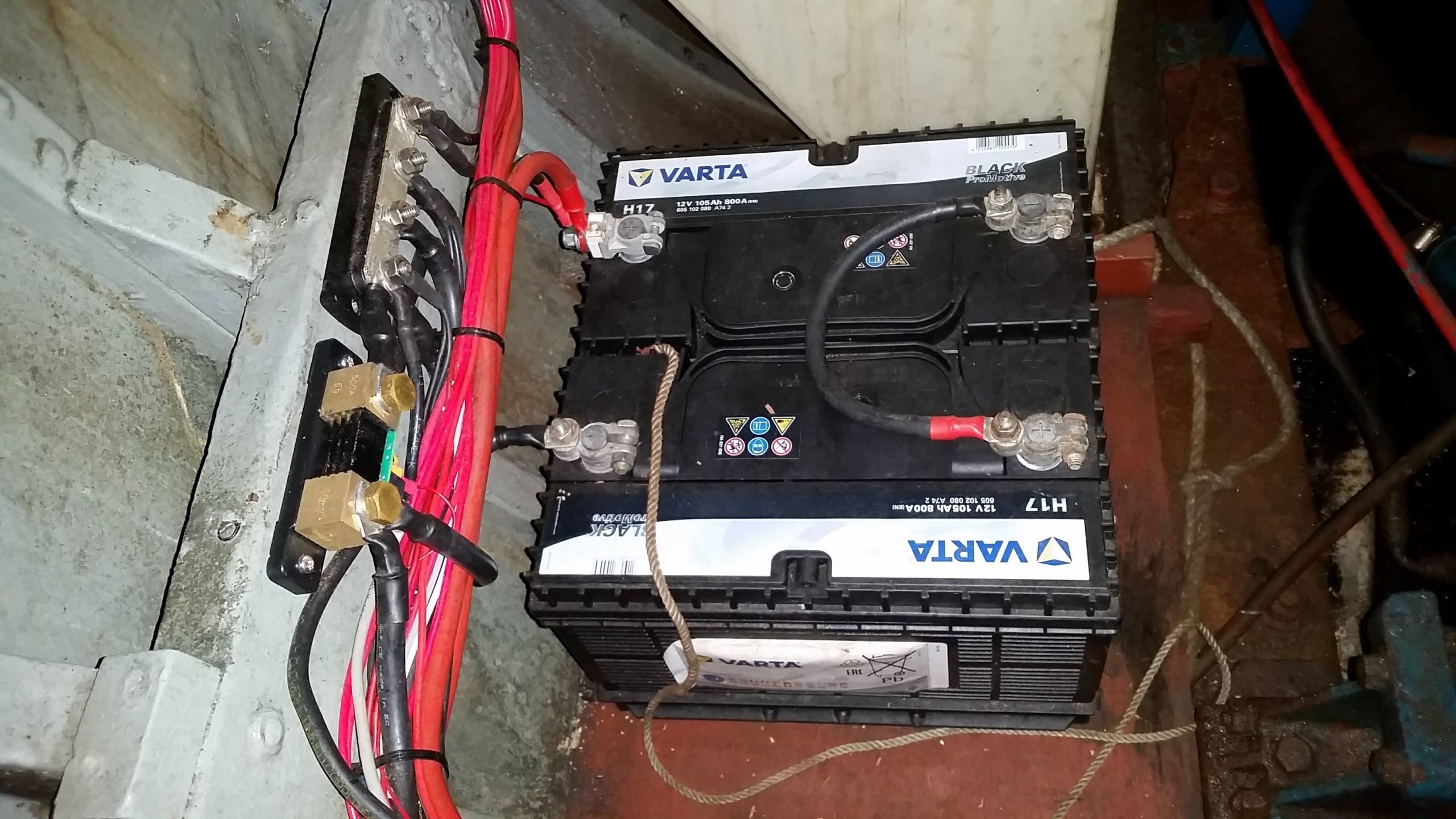

Before:
After:
I used to have few cables on battery terminals but as devices increased there was no more room so i added 2 bus bars with 4 X 8 mm crews. It worths doing that addition because everything is tidy and you can add circuits easily. I tape any terminal is uninstalled until its installed again. Wrenches are also sneaky always wanting to short-circuit the battery when I am not 100% focused!
