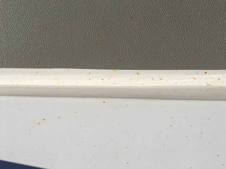

Iron filings all over Play d'eau
It was also nice to see both gennys at the Power Station fire-up the motors 100 yards away from you this week. I'm working across the marina from you Piers, polishing boats too. Fallout in St. Sampsons is an ongoing problem we have to live with there.
Indeed - and guess what? The ghastly generator start-up oil fall-out went all over Play d'eau requiring a full soft-wash as well.....

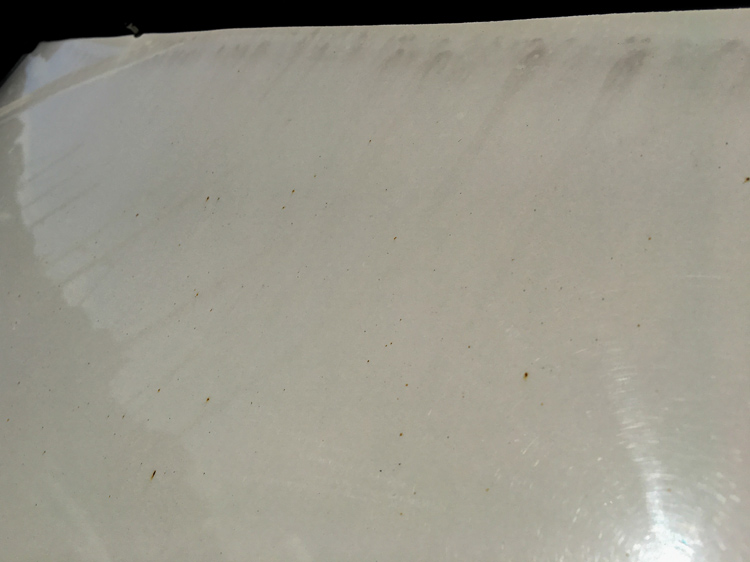

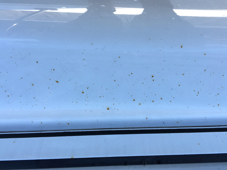

Photos (at last) taken from various places around Play d'eau before leaving Beaucette. Not a pretty sight. Even the rubbing strakes were covered.

Eeek. Is it like that all over? I hate to see what the other, worse affected boat was like.
Good pictures Piers, great focus.
I hope that all is rectified to your satisfaction.
Do mention or introduce Iron X to the guys with the difficult task of removing, it will certainly help loosen the bonding and be safer for Play d'eau's gel coat and could possibly be the only method for the non slip and teak.

Anyway, there really are filings “all over” and I can’t believe the operator of the grinder/cutter/whatever wasn’t aware. Properly negligent.
Getting it out of the non skid will be particularly bothersome.
Spray salt water over the bits they’ve done as that will show up any bits they’ve missed that haven’t rusted yet.
Thanks for the reminder. In talking with Fleming, they recommended not to Iron X due to the make up of the gel they used on Flemings up to about 2008.

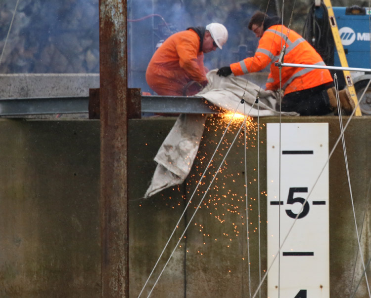

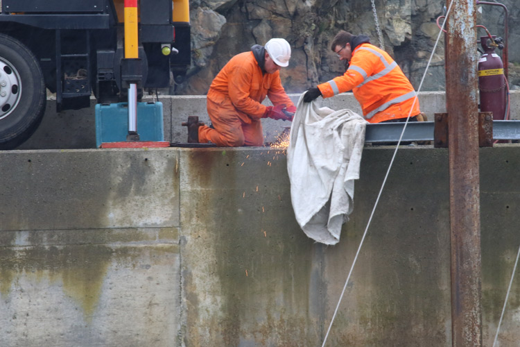

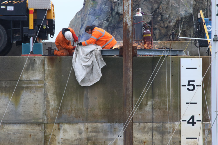

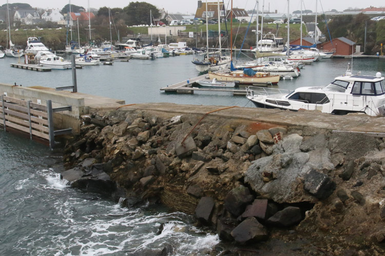

The owners of Temerity came to their boat, and unexpectedly saw this:
...you can see the mole and where the contractor had been grinding and cutting the iron girders for the new swell-break and pontoon girders (see left and right). Temerity is on the right.
The contractor returned, this time armed with a blanket to try and stop the filings being blown around. Sadly, the wind was gusty (SE F4). Trying to control matters was ineffective:

Just as they used to take photgraphs like this, surely it's not beyond the wit of man to develop a 21st century version for cutting and grinding near sensitive areas, to include air supply for the engineer.
Judging from how the fall out went all over the place, I don't dare thinking how much of that stuff ended inside the throats and lungs of those two chaps.
Not that this changes anything - neither for their health nor for the boats - but blaming the workers for their indifference towards boats means getting the wrong end of the stick, imho.
If anything, it's sheer ignorance which is to be blamed, here... :ambivalence:
