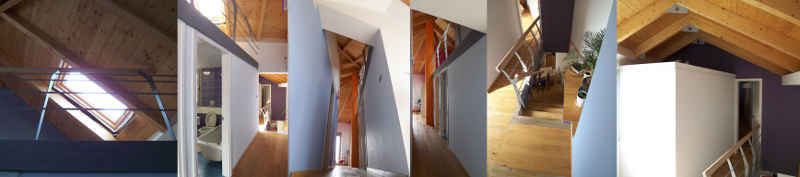

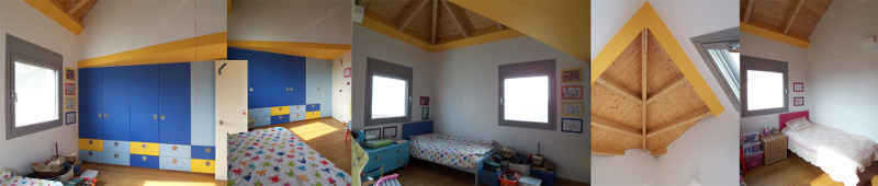

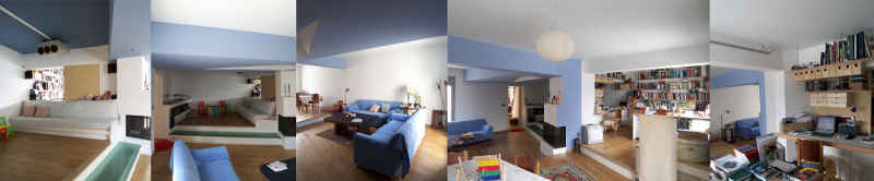

1. 1000x500 is too small. You'll have too many joints
sizes mentioned are purely indicative, will have to wait to see what I'm thinking but there should be panels 2000X500 as well as 1000X1000 in there. Re overall aesthetics will be edging towards de stijl and Piet Modrian composition II in red blue and yellow. Plain colours in largish panels with black wide seams obviously in good quality silicon.
Use fairly strong colours just to get an idea:
