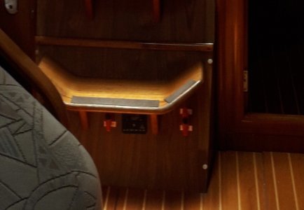

Hi tillergirl, thanks for your reply, I think we have different battery switches at bottom of stairs as per photo, there are 3 switches and a circuit breaker for anchor winch. The 3 switches are the + for Motor / + for House batteriies / and - ( negative ). I turn these 3 on before starting the engine.
1 battery ( the starting battery ) is isolated and is only for starting and we have other 2 batteries for services.
So do you think I should try to open the connections at these 3 battery switches and check the switches maybe there is an issue there? Thanks

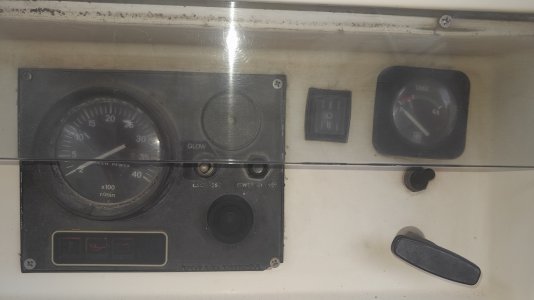

On my 2040 it was the connection of negative to the engine. Someone had neglected to remove the paint which meant that the starter wasn't seeing enough amps at the right voltage (Starter gets it's negative from the engine block). Do you get a good strong beep for several seconds when stopping the engine, or is it a weak/short beep?

Hi, thanks lustyd for your reply. I actually get no beep when turning off the engine :oops:. I just pull the lever at the bottom right hand corner and put it back in and the engine stops but no beep occurs. Not always but only when I put on the power on/off button, I hear a small beep. However as you mentioned the negative connection guess needs to be checked then. Thanks

I think as you have a much better battery switch set-up I would endorse Lustyd's comments at #6. Don't just look at the earth connection; undo, clean, remake everything.
