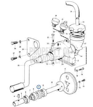

The rev counter sensor on an MD11C is mounted on the hand starting gear cover. It is part # 21 in the parts diagram
