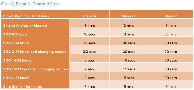

Isn't that how AIS works? How intermittent is your intermittent?
If there are many other AIS sets nearby, your turn only comes round occasionally. And if you're class B even less frequently.
