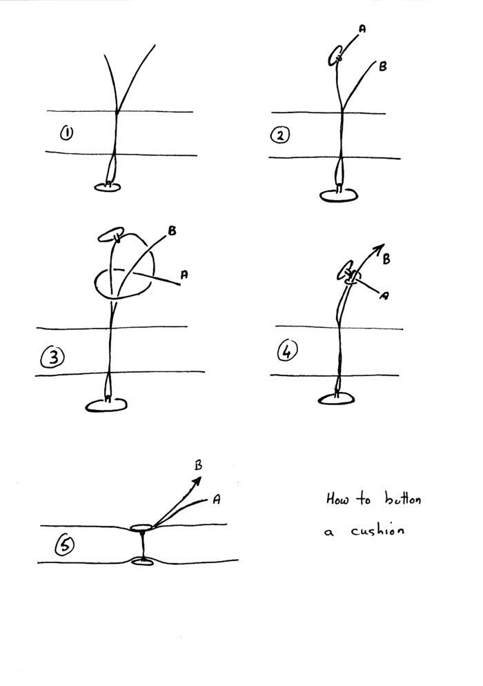

If you want them buttoned then here are the instructions http://i50.photobucket.com/albums/f337/Vic43/Forums 2007/Buttoning.jpg
