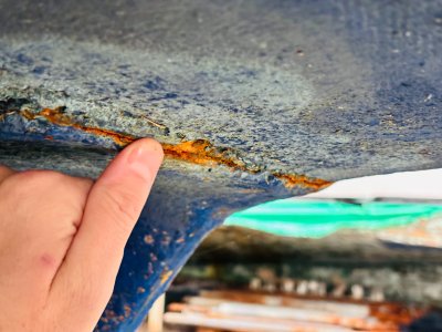

Interested in a Moody 419 but there are a couple things I noticed which I wanted to get a bit more info on to see if its an issue or whats would need to be done to make good.
1. Opening and rust on the bolted on keel where it meets the hull. If its normal when it comes to sanding and anti foaling what would be a good way to make all this good? It goes all the way around the keel.

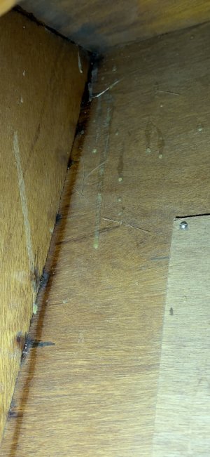

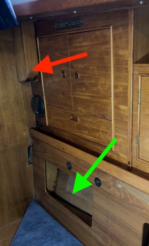

2. On the starboard side it looks like there is a leak from where one of the chainplates are screwed in. Could this be more serious than it looks?
Red arrow is the chainplate cover inside which seems to have that leak. Green is the areas I zoomed in on. and then the chainplate in question.

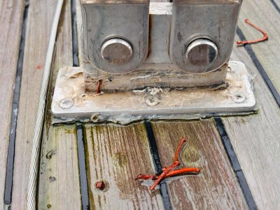

The chainplate leak is a headache for several reasons.
First, it is obvious neglect, you can see it has gone on for some while and someone has tried the dreaded silicone sealant to fix it.
Second, you can bet it is not the only leak and you would really need to take down the mast and redo all the chainplates for peace of mind.
Third, the boat has been in the hands of an ownership who have put up with this, so there may/will be other similar questionable things to emerge.
Fourth, there is a composite deck supporting that fitting and you would want to know that the internal sealing has not been compromised.
The overall condition of the teak deck also needs serious consideration.

I have a Sigma (same builder your prospective boat) from 1980 (4 -6 years older). The keel to hull joint is pretty standard it seems. The keel is iron, it will rust if exposed. killing the rust is easier on the non complex shaped areas - the flat bits / leading / trailing edges etc, but getting into the gap between the keel flange and the hull is a pita in-situ. The gap is typically filled with something with a bit of flex, but over time that may harden and the seal is lost, so the "not quite treated last time round" bits of iron can rust. (see below + photo)
As others have said, *could* be indicative of laissez-faire attitude to other stuff.
The chain plate - ~fairly common in the Sigma fleet (but then they are knocking on 40+ years old now). One of them is straightforward to deal with, the other is behind wood and requires cutting to access. Unsure about the Moody. Thought the decks are solid, not cored except: some areas do have ply embedded for hardware to mount, so check for springy-ness where deck organisers and other hardware has been fitted / moved / refitted etc but not properly sealed.
Photo - top - 2024/25 layup keel rust (and grime, post jet-wash) vs lower - 2025/26 (NO grime, post jet-wash - SML Cu-Pro working very well), the red is Hammarite Special metal primer applied liberally to stop surface rust. The spots from 24/25 pretty much came back this winter, so I wire-brushed and treated with a rust converter, then applied liberal primer to seal till the spring. (last winter I missed the rust converter step, but did epoxy prime before antifoul) My keel is pretty fair and not caked in years of antifoul, yours looks to have a thick layer of filler / paint, so you may need additional steps to remove / treat / fill & fair too!

Agree with the above. Chain Plate is a big unknown - you won't know how bad it is until you take the wood trim of and look underneath. you might also find the other side needs attention as well. The keel is normal. not difficult to sort, either hard physical graft to take it back to bare metal or more sensibly have it blasted and immediately coated with epoxy. If the boat is a keeper then consider doing the hull as well and Coppercoating. Obviously more money but worth it in the long rune. With a big old boat like this you are into a lifetime of expenditure so you have to decide where your priorities lie. The chain plate though is essential to get sorted.

Keel joint .... typical where it has not been maintained each lift out. Needs keel and joint brought back to basics and recoated / sealed. It would be good idea to check out the keel bolts ... which may lead to dropping keel to inspect main part of bolts.

Those runs are indicative of DIY squirt in some sealant and hope it does the job ... always fails because the fittings 'work' and the sealant cannot 'work' with it. Needs opening up and see state of the fitting ... possibly rebed.
Wet stained woodwork - not unusual on older boats ... need to find source of the wet ... which can be quite often NOT where you expect !! Sort the leak .. sand back the stained area ... apply suitable wood stain to regain 'colour' - then finishing lacquer.
Is there any movement at all (wobble ) in the keel? Not sure how you could test this.
At the very least.
1, Grind out with angle grinder all round until raw iron is exposed.
2. Treat exposed iron with "anti/de-rusting product.
3. Coat with appropriate sealer.
4. Fill with epoxy filler.
5. Fair.
6. Coat with sealer.
7 Anti foul.
Yes. It could. That doesn't mean it is.
The last photo of the deck chainplate fitting shows a rather pathetic effort of smearing everything with silicone.
The chainplate will go through the deck. It will either be sealed with a hard, inflexable sealant like epoxy filler or a flexible sealant.
Either way it has given up. Contacting a Moody owner's group will clarify this and let you know how serious or not it is.

I’m revisiting the boat and have asked to unscrew the wooden trim so I can see where the chainplate meets the bulkhead and inspect it properly.
