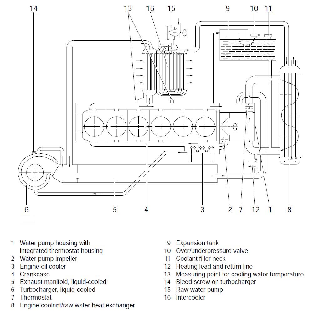

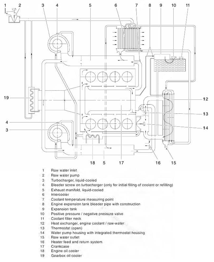

I am reposting a pic which some of you might have already seen in this previous thread.
Eventually, I found out the reason for the two separate sections which can be seen in the pics. Over to you guys, wadduthink they are meant for?
