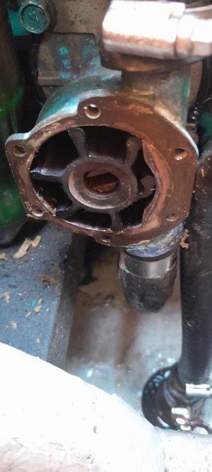

Hi All,
Would appreciate some valuable help.....
Whole story short;
MD2030 on 33 foot sailboat
Had a small leak in engine bay bilge ( salt water ) after cruising that increased to an undesirable amount. not too much but surely noticeable
Checked the raw water pump weep holes and there was water exiting that area, so I changed the seal at back of impeller ( including small gasket / o-ring; one behind it onto shaft ) and once at it, I changed the impeller, even though it was changed 6 months ago. Then after also inverting the plate cover the water stopped weeping from the weep holes, so I thought the problem was solved but not;
I noticed that there is a small leak ( could have been there ) coming up from the hose where it is connected to the raw water pump ( bottom part ). This hose in my engine comes from the back from the gearbox and from the gearbox then there is another hose to the strainer and then to the seacock. I therefore decided to change this part of the hose, the one that goes from bottom of raw water pump to gearbox ( i.e. feeding hose ), I replaced it and added 2 jubillee clips on both sides but the part onto the gearbox is ok..no leaks but the part onto the raw water pump is still leaking. When engine is off with seacock open there is a slight leak but when engine is on, the leak increases.
I appreciate any help on this please. Thanks to All
The attached photo shows the type of raw water pump before I changed the impeller and hose etc

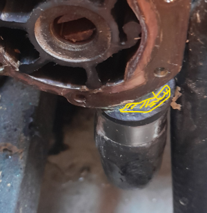

Hi Thanks for your feedback, the leak is coming out from the pipe edge with the raw water connection...indicated as per attached photo on old pipe....I should check the spigot, but the jubilee clip is to be tightened on the flat part of the raw water pump part not on the spigot? ( to clarify ) and maybe I use only one jubilee clip...the hose is way over long as I pushed it in quite firmly....thanks again
Might be worth cutting a couple of inches of the end of the pipe and trying again if the pipe is over long and try one clip slightly further down the pipe if the spigot is long enough. It looks like it should be an easy one to seal but being a heating engineer all my life I have repaired leaks only to eventually find the leak was actually higher up and running down.
Good luck.
Good luck.
Thanks a lot for your feedback, just to clarify, the clip has to sit on the neck not on the edge/nipple ( that's how I made it )
You do not need 2 clips. The spigot is designed so that the hose stretches over the nipple at the end and a single clip is used on the flat part. The water is not under much pressure at this point. The hose should be 19mm ID
It might be worth changing the hoses for new one. Old ones do lose their flexibility and sealing properties at spigots after a while. I have just changed all my hoses when I realised how old they were. I went for silicone rubber hoses - (search online) more expensive yes but superior to either plain rubber or what you sometimes see clear plastic with crisscrossed reinforcing.

Nothing to do with the problem I'm sure but the impellor blades seem to be wrong. The one on the cam suggests clockwise rotation but the blade two to the left (going clockwise) appears to be bent for anti-clockwise rotation. I'm just puzzling how that might be unless of course the impellor has just been fitted and has not been rotated.
Agreed when installing the new one I now made sure that it's all in a clockwise rotation now tnx
