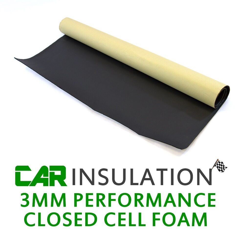

I was going to use self-adhesive van lining, but there is not a lot of insulation in that . . . . what about this stuff with teh carpety stuff on top?
https://www.ebay.co.uk/itm/3mm-Blac...-Roll-High-Quality-Waterproof-UK/262418073209

Funny you should ask, i am currently lining a couple of wardrobes myself. I'm using some double sided adhesive coated closed cell foam ; https://www.hawkehouse.co.uk/product/rw70-self-adhesive-closed-cell-foam-5mm-double-sided/
Not the cheapest, but as it's an arse of a job i'm more interested in it lasting for a long while, rather than saving a few quid. You can go over it with vinyl or even foam backed vinyl, so i image the carpet would work too. I'm going to go over mine with foam backed vinyl. It's certainly easier to work with than foam backed vinyl and contact adhesive.

My for and aft cabin will need doing in the next few years. I am exploring using a closed cell sleeping mat material under the existing vinyl lining.
On the last boat I used some https://www.hawkehouse.co.uk/product/rw70-self-adhesive-closed-cell-foam-5mm-double-sided/ that was horrid to work with.

I am looking for something a bit thicker than 3mm as I have plans for some voyages north of Shetland in the future.
