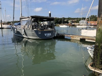

We started hanging our dinghy off the stern gantry about two years ago. I still have to remind my crew of it every time we leave port, especially since we got a larger dinghy with bigger tubes last year.
Our ship is pointy at both ends. Dinghy is 2.6m on 3.35 beam.

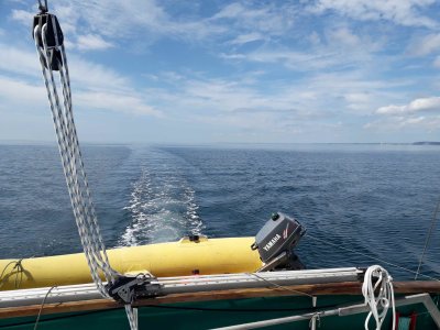

We ‘hang’ ours from lines over the pushpit rails whilst using a block on the backstay to lift it, but once secured there is no load on the back stay. Dinghy weighs about 26kg and won’t fit in the foredeck due to the babystay.
It doesn’t keep it as high as davits, when heeled well over it can slip to the low side and catch the waves, but most times pulling it a little higher or adjusting the lines gives it enough clearance.
For our use it works fine and with the ready made lines and snap-shackles is just as quick to use as davits.

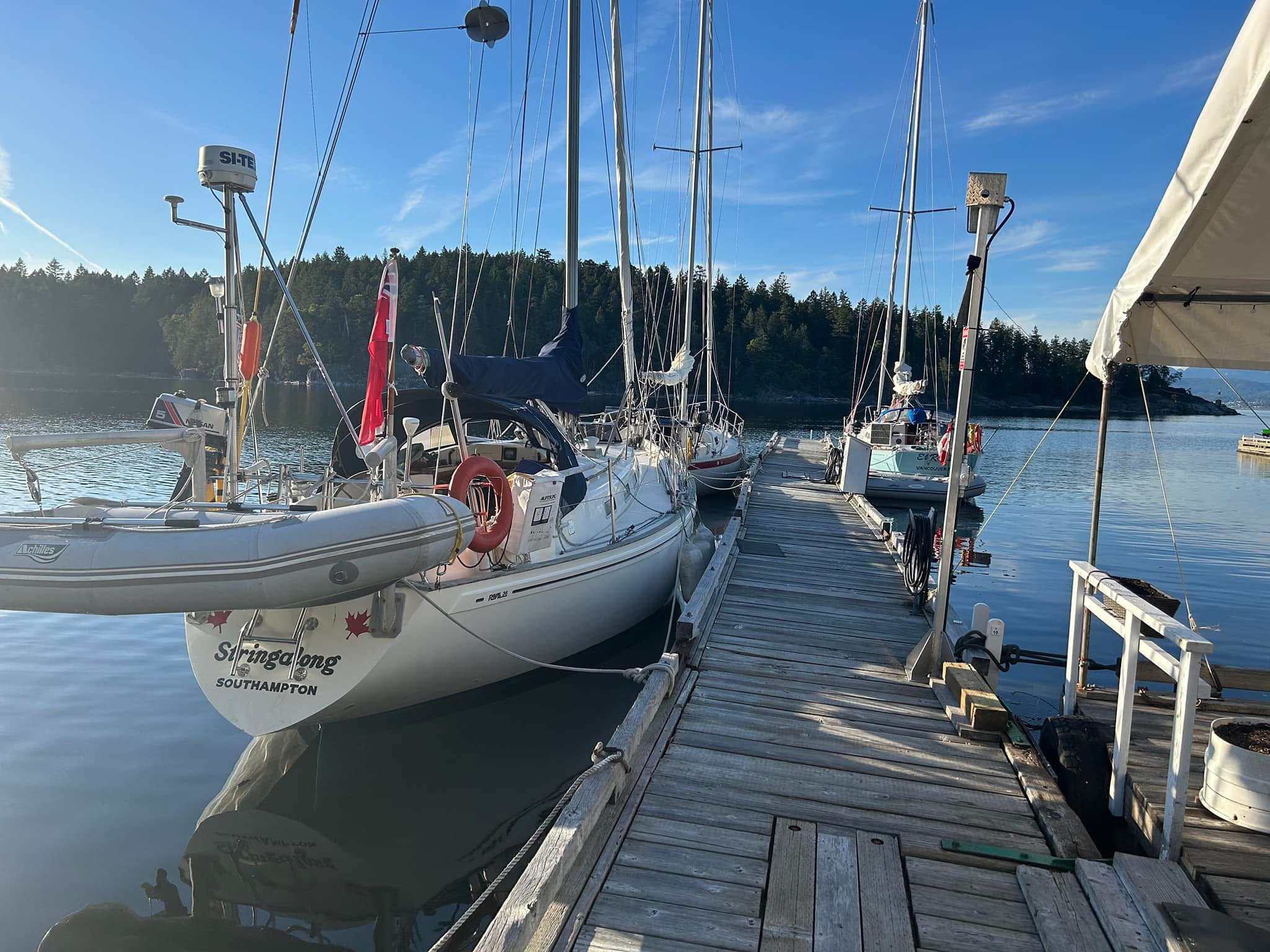

My boat (35' hull) came with davits and they were massively installed from new with backing pads etc. They swing inboard 180 degrees when not in use. They turn my 36 into a 40 but outside of marinas I don't notice them.
They are great for cruising and quick and easy to use. I don't leave the outboard on but could. I have a 2:1 purchase on a 2.4m dinghy.
I agree with comments about keeping it up high as it can catch the water when heeled in seas. Water can collect in it, but not excessively when sailing as it slops out or drains. It needs well secured to stop movement in rough weather - I use two fenders to stop chafe.

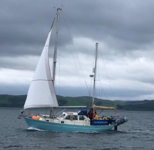

Each boat is different and with a reverse stern #10's solution with or without davits looks good.
This is a 36' boat with narrow stern that demonstrates that davits can be fitted onto special brackets mounted on the outside of the stern. In this case it allows the davits to be raised slightly higher than the davit base, flush mount option if fitted through the deck at the stern. No doubt a suitable raised table arrangement could also be fabricated inside on the stern.
