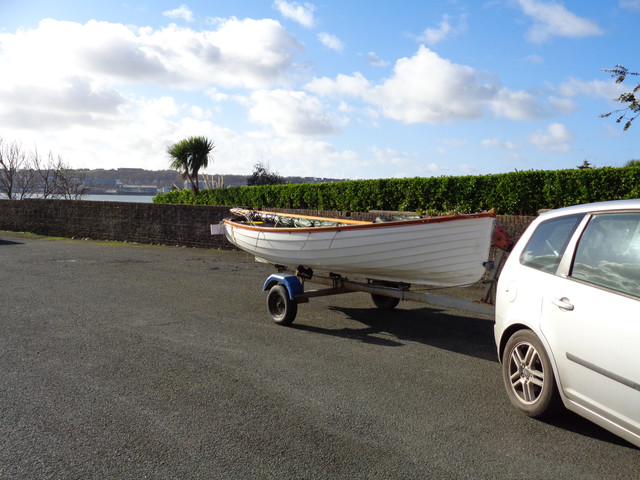

but I'm confident the Denizens of this Forum will have the knowledge I seek. A 14 foot traditional 'Style' Dinghy, Gunter rig. it's a big Trident clone, and for the first time I am going to antifoul the boat as it spends far more time in the water than on a trailer.

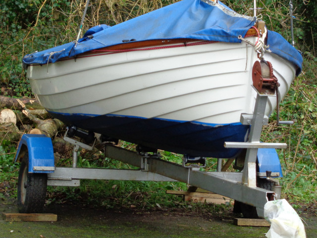

So far... while she was afloat I measured Gunwale top to water, she was fully rigged and loaded for an overnight cruise but I did the measuring from the Pontoon. Now on the Trailer, I transferred the measurements to the hull and marked them at six positions along each side with a felt tip. I have now run masking tape along the marks...Not easy, skipping down from strake to strake in places, but it looks reasonable eyeing it up from ahead and astern.
Before I cripple myself squeezing under the trailer waving a paint roller, have I missed a trick? Any tips or advice would be welcome.
