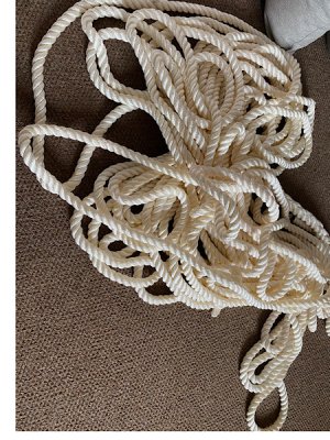

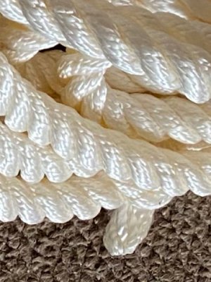

I've got a 40+m of unused 3-strand 18mm diameter rope which I'd like to cut into a few smaller lengths and splice loops in the ends to use as mooring lines. Question is how to identify what it actually is? It's a sort of cream off-white colour, man-made (melts), softish and quite shiny/slippery (as new rope tends to be). Here are a couple of pics:

That looks astonishingly like some nylon I have used successfully for mooring buoy lines in the past. Markedly shinier and slipperier than new polyester. It barely floated though. Ordinary nylon is not great for UV but some has additives and copes well. I bet it will be fine.

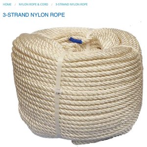

Thanks for all the help folks. It doesn’t float, so not polypropylene - which is good news. The burn/melt test in the video makes it seem more like polyester but I’m not sure. I can’t find any polyester that colour for sale, but it does look exactly like this:
I’ll get splicing.
