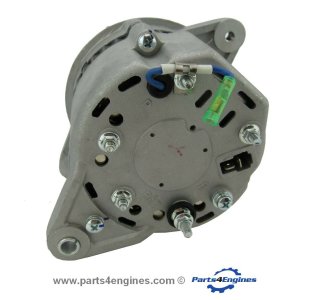

Can you identify what each of the terminals here are, and is one of them the elusive W terminal for a tacho?
Assuming it is for a Yanmar.
Picture of original Hitachi alternator not your Bosch replacement
The extra wire is the W for a rev counter (should have an inline fuse)
What andsarkit says. ................

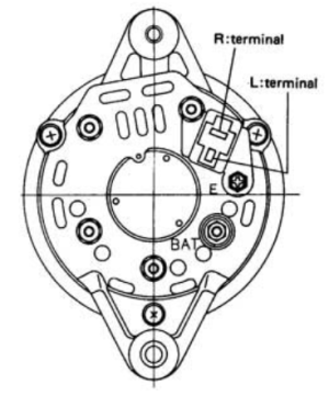

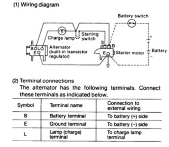

The tacho connection on Hitachi alternators is "P"
L is the warning light connection
R is the excitation connection which should have 12 v applied from the "ignition" switch when in the run position
