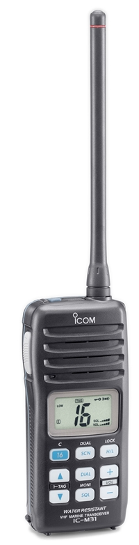

I have an Icom IC M31 which ( I think ) has a duff aerial:
Is there any easy way of attaching a makeshift aerial to test this theory? It is the common screw on stubby used on a number of models:
.....I envisage spending no money, bunging in a length of coax with matchsticks; that sort of thing.
Thanks
What makes you think the aerial is the problem? What is the problem with tx or rx?
A simple test would be a 50cm long piece of straight wire inserted into the screw connector. That is roughly a 1/4 wave whip aerial. But only try it on rx it won't be properly tuned for tx (though a decent radio it would do no harm, just not work very well)
