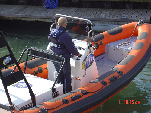

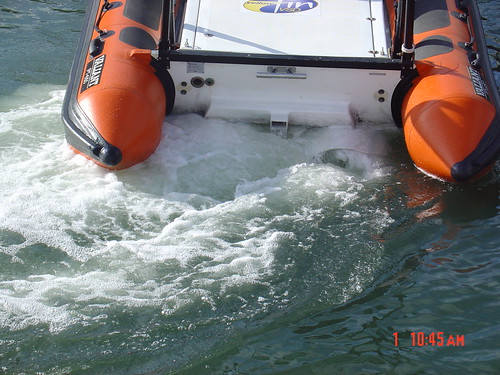

Doing this
yes its yellow fin, I asked him just to make sure. /forums/images/graemlins/blush.gif

Great shots, cheers
It's a very interesting concept (yellowfin), but guess the challenge will be to make it reliable

The guy was just making the boat dance, it looked easy to handle , so would be fast to pick up and use.

Are you sure it was yellow fin as I saw a very similar RIB last year doing what you photograph but with jets.
Doh - just looked athe pix again and it says Yellow fin - also the engine room is much smaller than the one i saw.....

Google Yellowfin VSD for lots of pages. I discovered that the drive doesn't actually go into the water, just the blade that is currently at the bottom of the hub.
