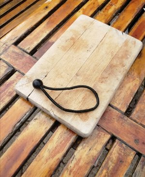

Add in extra sheets for poles, pole downhauls, main gybe preventer, spare sheets for the Solent jib and you can see the scale of the problem! My solution is to fix them to the many handrails on the boat using a short loop of elastic with a ball on the end (I have 40 from an old trampoline!). It may look messy but everything is secure but to hand when needed.

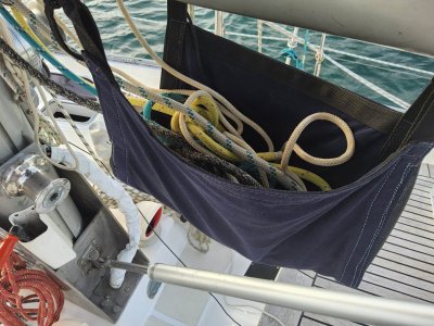

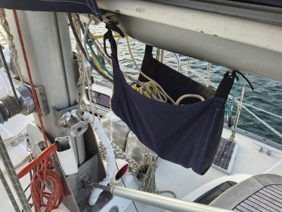

We don't have bags for halyards but we have a bag suspended under the boom at the forward end for the 3 reefing lines and outhaul. It made from acrylic canvas and phifertex. It keep the lines tidy and available when reefing. We fitted it about 4 years ago and love it

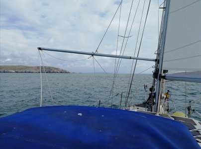

My reason for mentioning ... my halyards are oversized - I had a very generous offer on Kingfisher rope to replace all my halyards / sheets couple years back. I replaced same size as old - but always knew previous owners had oversized ...
This gives a lot of bulk to sort at mast base ...
Grab that lot ! :
Before anyone says change for less diameter rope - I will say I am not planning to - I'm not one to open the wallet so easily !! :eek:
I did have small light line loops that held the coils by passing through and hooking back on cleats ... but one by one they got lost ... so back to 'seamans' way .....

Congratulations, great picture. You're sailing a proper traditionally rigged boat. Light rope loops is a good solution provided you have enough cleats or attachment points. I use these and attach to handrails or similar. Screenshot_20230622_093639.jpg
I also attach things to the pulpit and lifelines but not usually halyards or rope coils (except the anchor buoy and trip line. The boat ends up with a lot of ropes attached to various places. Not suitable for racing (cabin floor) but suits me sailing singlehanded. And I learnt to sail with deck ropes, not led aft to single winches. Screenshot_20230622_093424.jpg

Agree that others coiling ropes too tight is a problem. For cruising, ropes all over the deck or cabin is not good either. I use a loose coil as you would do for a throwing line, secured with a small separate loop, or the rope itself as in Refueler pic. I do the same with mooring lines in preparation for docking. Usually falls free ready to run when released. Key is to not tension the rope when coiling, depends on the rope too.

In my picture earlier - You may notice that a couple of lines actually get coiled and then placed behind the line against mast above the cleat. This is a trick to add a slight bit more tension on a line ... you sweat up the line - make fast ... then coil - place line behind itself - adds just a touch more and keeps line out of the way.
Ignore the slack main luff ... that was just a lazy day out in Solent ...
