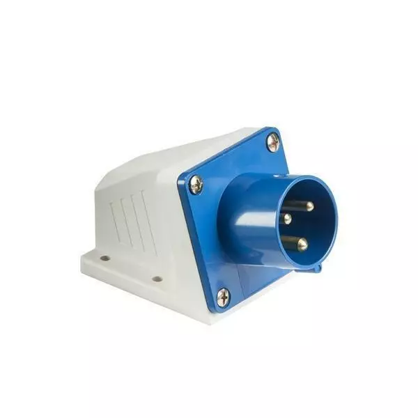

The word "socket" in both of the links in post#11 from Refueller worries me. The upper one is actually a surface-mounted plug as we can tell by the visible pins. The second one has only one view which doesn't show whether it has pins or whether it is really a socket with holes for the pins to enter. When installing a terminal for receiving shore power it MUST be a plug, which will accept the flying socket on the end of the cable.
The item fitted to the boat should have PINS ready to engage in the HOLES of the trailing lead plug. Simple really ......
If the trailing lead has PINS both ends - watch out - you can have a nasty shock .... possibly fatal. The cable should have male one end and female other. The male plugs into shore ... female plugs into boat.
In my post #11 ... the first is CORRECT
The second is wrong - but the correct male PIN socket is same design ... this is what I use :
