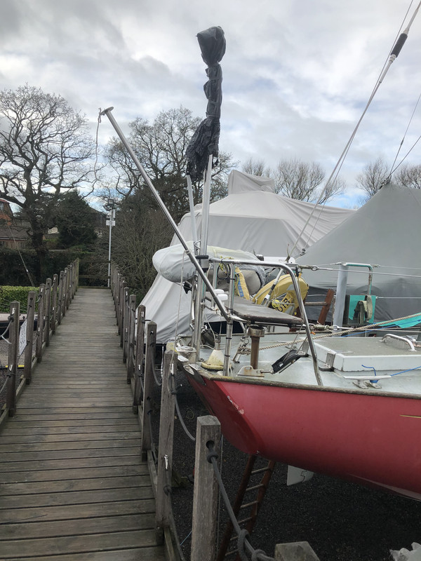

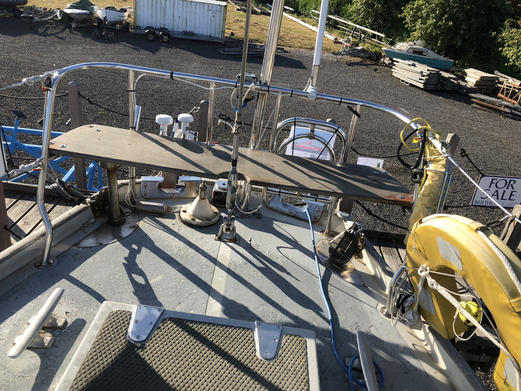

The pushpit is a bit busy! But any older counter sterned boat would find it hard to fit the liferaft cradle on the pushpit, I think.

I really don't see what is so busy on the transom that a little tidying up might not resolve - why are those GPS aerials (for example) not on a pylon and the cables not threaded through the stainless tubing. My guess is you will need to invest in some electric winches - tidying up the exisiting transom, in comparison, should be cheap and just housework :) .
You might need to invest in a ladder to allow easier exit into the raft/water (with a gap introduced to the lifelines (pelican hooks would fit the bill).

I’d sit it on top of one side of that seat by the back stay. You might be giving up a bit of seating area, but needs must :)
Or get rid of half of the seat?
