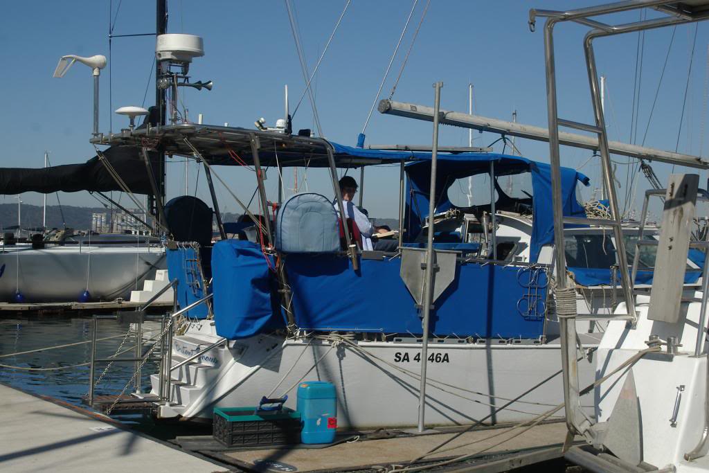

This is where my 6 man life raft is positioned under the blue cover right aft
The stern steps could help boarding but anyway you should step UP to board your life raft.
