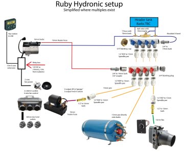

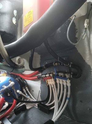

I’m planning a hydronic installation for next winter on our 3 cabin Hanse 370.
Plan is eberspacher d5wsc (5kw hydronic), connected to dual coil calorifier and heating circuit.
Will have valves the classic “summer valve” to isolate calorifier and heating circuit.
Planning on replacing calorifier for a 30 or 40l one under the port aft bunk. Planning on the following matrix heaters:
4.7kw in main saloon.
4.7kw in forepeak
Double duct one to do both aft cabins
Single duct to do heads.
