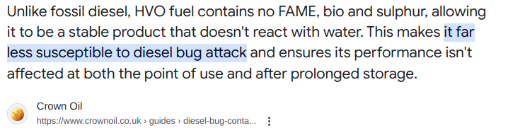

My motives for exploring the option of HVO were rather selfish in the I was concerned about the benefits of less risk of diesel bug and a cleaner exhaust and less diesel smell from a cleaner product with a longer storage life. Do these offset the increased cost and effort involved given the product is on the market. The volume used in a small niche market will make little impact on global issues maybe.
Yes, my reply was more to address the concerns of Boomerangbens post #9.
From your angle, my view is that HVO most likely would reduce the risk of diesel bug a bit if compared with road diesel, as this usually has a FAME component, which I understand attracts water. But as Freebee stated in post #4 bug can feed from HVO (or from 100 percent fossil diesel) if water gets into the fuel tank. This is supported by my own experience, having just found bug in the tank despite having used very little or no road diesel for the last 10 years or so.
