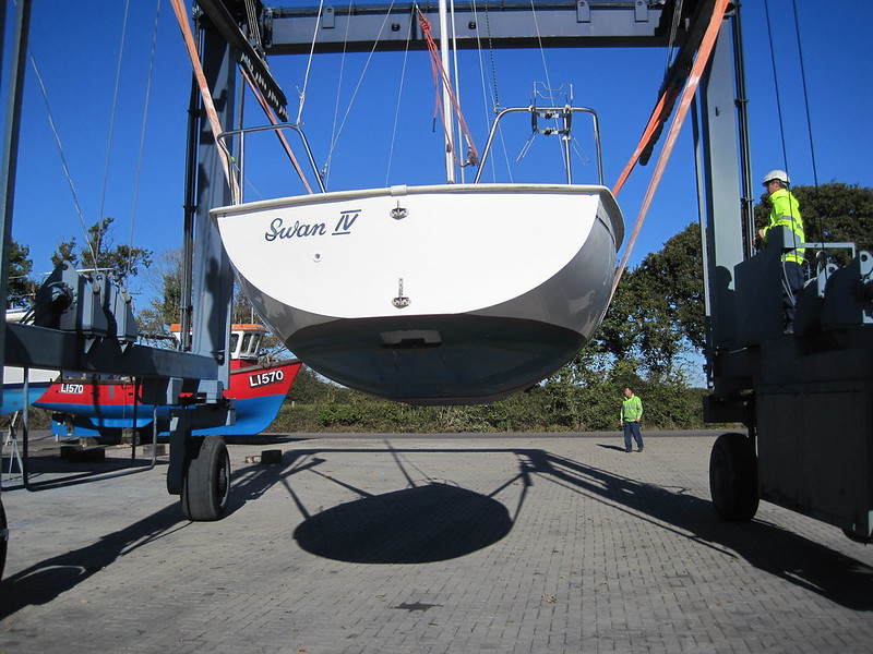

IMG_3668 by dralowid, on Flickr
In this pic you can just see that the Jaguar has a flat section that runs from just in front of the keel to the stern, apparently to aid planing but also helps her sit on the beach nicely.
