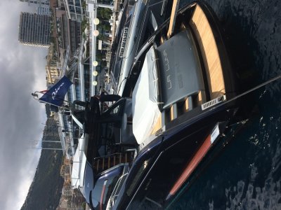

I distinctly remember how it entered the conversation…….I was helming a trad blue Itama 62 and when back at the dock I enquired about a “ white “ one from the previous years show ( actually not white a kinda cream ) and conscious of a recent F1 connected guy taking delivery of a red rosso Corsa 62 .Basically Itama we’re coming out all sorts of colours instead of trad blue and Pershing getting more adventurous colour wise . Against this conversation I asked how much for a gel coat colour change ? Thinking it pretty easy to sub out the gel coat for any other at the buyers request.
Only to be told “ they are all painted “ no coloured gel coat just give us a RAL number .
The knowledgable guy waving his arms around the dock “ they are all painted “
Even Ferretti beige I did specifically ask as then two forum members then had beige Ferretti and it’s a signature colour .
So off we trotted ( dog in hand ) on to a Ferretti for me to tap my finger nails , rub my hand , stroke the finish beige only to be told it was all paint !
BTW there Pershings we’re all colours .
I think the CRN s are painted too btw an equivalent to your new SL in build .So I can see why you are pushing back on a rivals transparent gel coating vac bagging .
Maybe SL Vac bag differently ? Get better results than Gregs manufacturer , Princess and every FG brand .Just saying why they use transparent and reporting on FG s usage .Make of it what you will . But knowing the reasons why some manufacturers have started to use transparent gel with vac bagging I would want to know why your manufacturer isn’t doing that ? Or turned around why Princess , Greg’s builder and FG have adopted it ?
But I got it from the horses mouth .

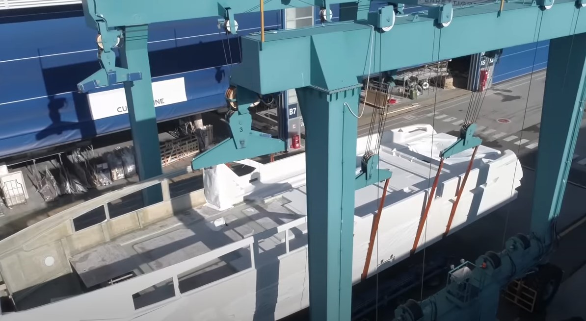

Ok vid here .Could be any of the FG brands .
You can see a Pershing in grey primer moved about , not the unfinished top sides decking ares not primed when it’s moved to the paint booth .
Also note the end 1/3 where they spray he whole lot , well the visible bits to customers spec colour .
Note the metal 140 at some point so they know there onions re paint theses days.Remember all metal boats are painted
you can glimpse unpainted interior , clear insides of plastic the hull s well in the vid .
Agreed it doesn’t show a transparent one popping out of the mould , but the gray / white beliw the WL has been through the quality control and basically primed.
They make all there plastic boats this way nowadays.

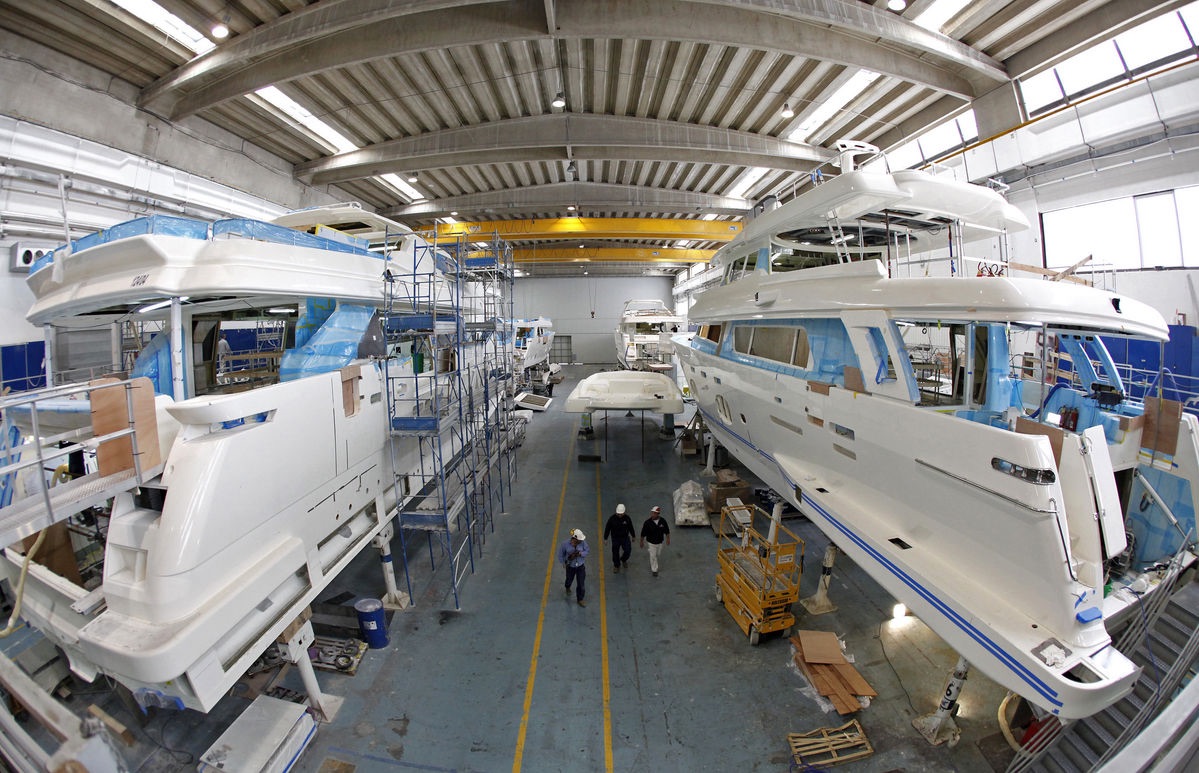

I've corrected you many times. You may have been told this by some yacht sales folks who (evidently) don't know tons about yacht building, but that doesn't make it right.
I don't want a long drawn out debate, but this forum is quite a decent source of yacht information, so when someone (mainly you) posts something that is 180 degree incorrect, it's useful (imho) for it to be corrected. I'm also not trying to "push back on a rival" - I didn't have to buy a Sanlorenzo and could have easily bought the same size Ferretti if I thought they made better hulls (and saved €1.5million in the process).
I have been to these factories; you haven't. I have also looked closely at these boats, as you have too (at yacht shows). You amusingly state that you couldn't tell they were painted - the reason is that they weren't :) :).
Two pictures below:
  • The first is a Riva Argo 28m hull arriving at the La Spezia factory (which I have been to) by barge from Ferretti's moulding factory. I think we can agree that if this yacht is to be painted (which it is, in silver) it hasn't been painted at the time of this picture. It has white, not clear, gelcoat.
  • The second picture is Ferretti Custom Line at the FG factory in Ancona. I hope you can also agree that at this stage of build, the yachts on the left would not yet have been painted if it were going to be painted - it doesn't even have the exhaust duct pod attached to its hull yet. White gelcoat, not clear, and as you will see it is highly polished because it is the finished surface.
So it's just not correct that all FG hulls are made in clear gelcoat then painted. These pictures are not wrong.

Not sure why you're posting that. Nothing in that video shows clear gelcoat across the FG range, which is unsurprising because the video covers only high end Pershings, which have plenty of carbon and epoxy resin elements, and are always painted, usually silver but sometimes painted white (as you know). But your "Everything you see below is paint over transparent gel coat" statement in #16 remains incorrect, as my photos above prove.
