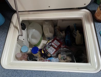

Our Bavaria 40 has a fridge that works really well... for about a day, then the evaporator plates all freeze up and cold air stops circulating around the fridge :confused:.
I've added some seals to the top of the fridge to try and stop moisture getting in to help prevent it freezing up. Would a desiccant dehumidifier in the fridge help this?
The alternative is get a separate Dometic unit and just use the fridge as a cool box?

The standard Bavaria fit top loading fridge has no seals at all on my 2003 boat, which is a bit bonkers. I fitted some draft exclusion strips, however, as there is no way of clamping the lid down, I don't think these added seals get compressed enough, or are the right thing.
Our fridge has an oval flat plate evaporator that gets cold enough for ice cubes but doesn't ice up enough to stop the fridge working. Maybe a flat plate evaporator would be better than the finned version you have?
I spoke to the Dometic stand at the boat shows, and they were super helpful. He said your type of evaporator (with a plate) was more modern and much better, and I should just swap it out for one of those. This is probably the best fit, but in season I don't want to waste any sailing days.

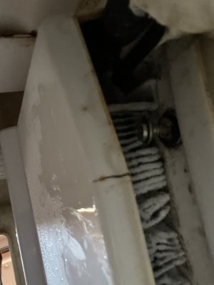

Nope, it is as old as the boat (20 years!). The thermometer and temp control was replaced by a fridge engineer on a cruise two years ago and the whole system was re gassed and checked. The air circulation is the real problem, as when the unit freezes up, the air from the tiny fan (scroll down) on the fridge cannot pass enough air over the fins, meaning the fridge warms up and spoils all our food. We only go on longer adventures in summer, so I guess we have only noticed when it is hotter.

As you can see from the above, the evaporator itself gets cold, and the compressor does stop (presumably because the fridge thinks it's all cold enough), however, the fridge itself is all very warm indeed away from the lump of ice sitting in the corner. :cautious:
