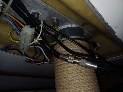

The mast on my 38 has following :
a) B&G Wind cable
b) Masthead anchor light / tricolour combo cable
c) Steaming light cable
d) VHF coax
e) Broadcast radio antenna coax

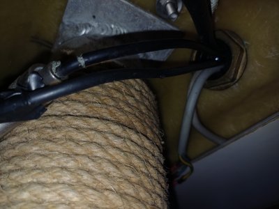

Previous owners had all 5 cables bunched together entering via a round gland with what appears to have had a clip on style - the clip on cover missing by time I bought boat !. Whoever stepped mast last time .. wrapped self-amalgamating tape over tope of silcon trying to seal the cables ... a real mess that leaked .. No real surprise with 5 different sized cables bunched and passing through a round hole !
The question is now - how to solve this - I don't really want to start cutting 4 more holes to cater for each one ..
The deck socket is only about 10mm proud of the GRP .. so difficult to sort something to it.
The B&G cable has multi core proprietary plug / socket inside deckhead ..
as do the VHF and music radio coax's .. the light cables are spade joints.
What to do .. I thought of cutting a short lengthy of pipe sleeve ... pass all cables through .. and then seal with silicon into the deck fitting you see there .. but its still 5 cables bunched together.

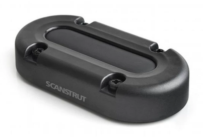

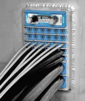

As you probably know, big ships use a cable transit. If you can find a small one it is possible to remove individual cables or add new ones.
scanstrut do a small one but it is nearly £50.
Scanstrut
