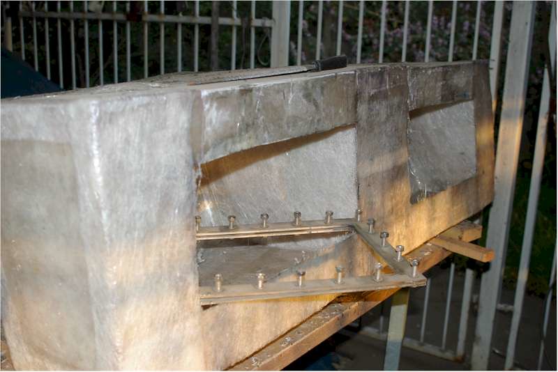

I made a fabricated GRP waste tank as stainless would not last long.
This is my initial fabrication using flat GRP sheets. From this I layed up several layers of GRP on finished inside with ceramic flow coat.
