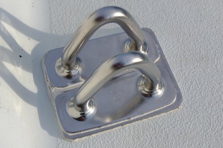

2) How much to torque the bolts. It's my rigging so I want them tight but I don't want to crush the deck. The U-bolts are 10mm 316 stainless.
3) How to ensure they don't come undone if the butyl oozes more in hot weather and relieves the tension in the bolt. There isn't room between the bottom of the deck and the headlining for a second nut or similar.
