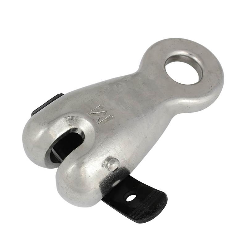

I already have the chain hook, one of these...
which the nerd in me is pleased to see is made out of duplex stainless steel.
I had a 12m catamaran and made each leg of the bridle equal to the beam which was 6m. I gave up using chain hooks after breaking a very expensive one when hit by a sudden katabatic gust of 60 knots. Instead, i used a rope tail about 1m long attached to the bridle's apex with a sheet bend knot. In turn, the tail was attached to the anchor's chain using a rolling hitch. Easy and quick to tie and always undoes once the load's taken off it.
