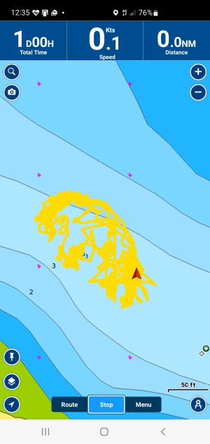

I work on the basis that it's the chain that does the work so put 50m on our 38 foot. Lifting keel, usually anchor in 2m at LW, so up to 6m typical Solent, SW tides. If it's going to be windy and we've got room, I put loads out, otherwise 3x for lunch 4x for overnight.Screenshot_20250715_123552_Boating.jpg
