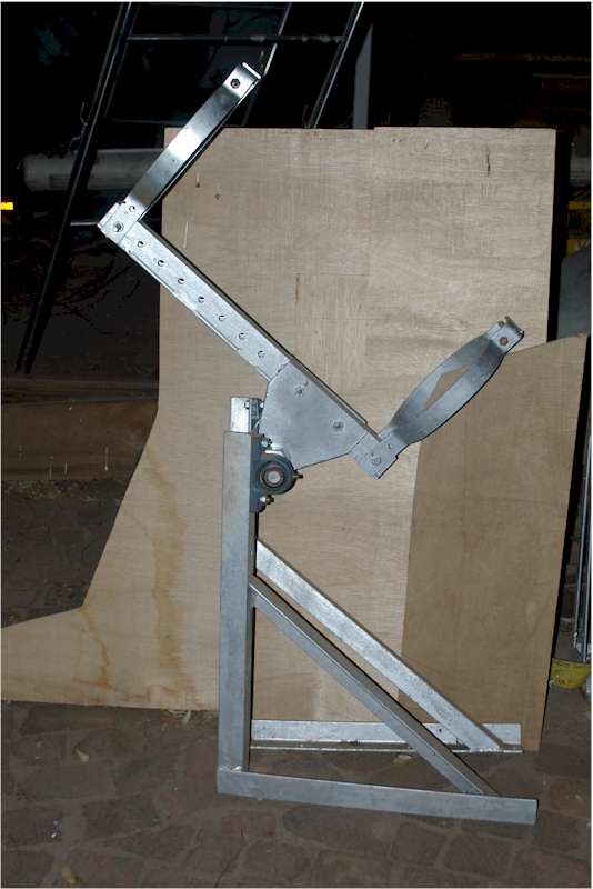

This is a temporary attachment for my mast so it can be raised from the horizontal.
This is bolted down to the deck with the mast base attachment bolts and the oval shaped ring is clamped to the mast.
These are 2 A frames bolted to the chain plates for the forward and aft lower rigging and the upper rigging is clamped to the A frames in line with the mast pivot bearing
This is one of 2 pivot points that a lifting A frame is attached to and lifted to be vertical when the mast is horizontal.
The forestay is attached to the top of this A frame and a heavy duty line runs from the lower end of the forestay to the windlass for raising the mast.
The back stays are attached to control how high the mast can be raised so it will not go too far forward.
